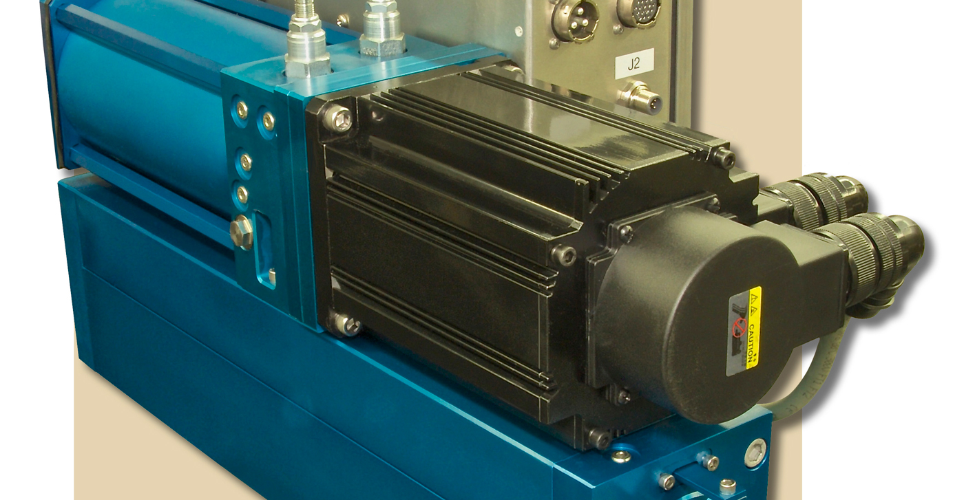

An electrohydraulic actuator integrates a hydraulic cylinder with a controller, motor, pump, reservoir, and control manifold into a self-contained solution. An EHA may not seem all that new, but Kyntronics combines a drive, servomotor, manifold, and cylinder within a self-contained package. A key element of the Kyntronics EHA is a rod-volume compensating mechanism, which compensates for the differential volume between the cylinder’s rod- and cap-end volumes as the piston rod extends and contracts. The rod-volume compensator uses closed cell foam wrapped around the inner pressure cylinder.
The modular system starts with a bidirectional ac or dc servomotor driving a gear pump. This eliminates the need for a proportional directional valve because the motor controls flow rate and direction. A big advantage over conventional hydraulic solutions is energy efficiency. That’s because when no pressure or flow is needed, the motor consumes no energy. And when holding force with no motion is required, the motor maintains torque to hold pressure.
These general features make EHA technology attractive, but one beneficial feature of the Kyntronics EHA is the way the differential volume is accounted for between a cylinder’s cap and rod ends. For example, when the pump routes fluid into the cap end of the cylinder to extend the piston rod, fluid flows from the cap end at a lower rate. Likewise, when the pump routes fluid into the rod end to retract the piston rod, fluid flows at a higher rate from the cap end.
To compensate for this difference in volume, the hydraulic cylinder includes an outer low-pressure cylinder, which creates a chamber between the two cylinders. This chamber contains compressible foam to serve the same purpose as an accumulator in conventional systems. The foam, however, does not require an initial precharge, nor does it require any maintenance.
The Kyntronics solution provides power on demand and delivers the most efficient (50% to 80%) method of converting electrical power to mechanical power. Overall efficiency using a combination of hydraulic and electrics far exceed that of the other individual methods discussed here. A smaller motor can be used for similar loads compared to using an EMA. Doing so reduces size, weight, and overall costs. This solution can be oriented in any position and eliminates the hoses and potential leaks.
Other Design Features
Those familiar with hydraulics may question how heat generation is managed in a hydraulic system that has no external heat exchanger. The system uses proven design practices for low heat generation, such as large port openings, as few right-angle bends as possible, and taking advantage of surface areas to transfer heat to the surrounding area. Extensive tests and field installations have proven that operating temperatures stabilize well within the specifications of the oil.
The cylinder includes integrated position and pressure feedback sensors for closed-loop motion and force control. The EHA solution accepts multiple ac and dc voltages and easily connects to popular fieldbus systems (CAN, Ethernet, etc.). The EHA can withstand high shock loads and does not require a brake to hold position. Its modular design allows assembling the EHA to individual application specifications, thus reducing lead time over custom solutions.
The unit’s drive controller can be pre-configured to reduce setup time and eliminate programming. However, software is available to setup or change desired indexes as needed. One can easily select a position controlled index, set up the speeds or desired forces, and connect up the actuator, and then it’s ready to go. The Kyntronics EHA accommodates loads to 24,000 lbf, speeds to 20 in./sec, and strokes to 78 in. or longer from ac or dc power.
