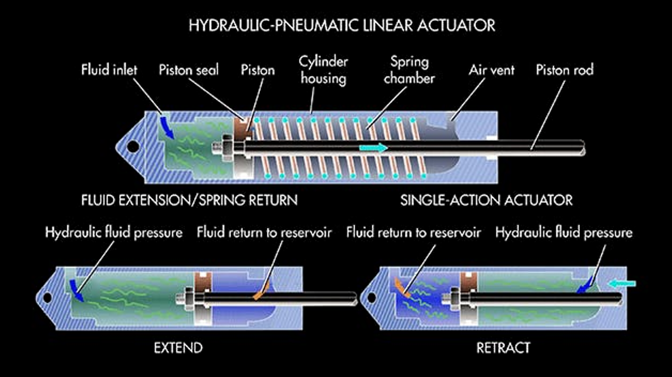

Pneumatic Actuators
Pneumatic actuators have a piston inside a hollow cylinder that is moved through that cylinder by pressurized air entering from a compressor or pump. This linear motion can move a load or create a force. The piston returns to its original position using a spring or pressurized air supplied to the other side of the piston.
Most aluminum pneumatic actuators carry a maximum pressure rating of 150 psi. They are available in bore sizes from ½ to 8 in. and can create 7,500 lb. of force. For higher forces, steel actuators have a maximum pressure rating of 250 psi with bore sizes from ½ to 14 in. They generate from 50 to 38,465 lbf.

Hydraulic Acutators
Hydraulic linear actuators operate similarly to pneumatic actuators, but a pressurized incompressible liquid (hydraulic fluid) supplied by a pump rather than pressurized air moves the cylinder.
