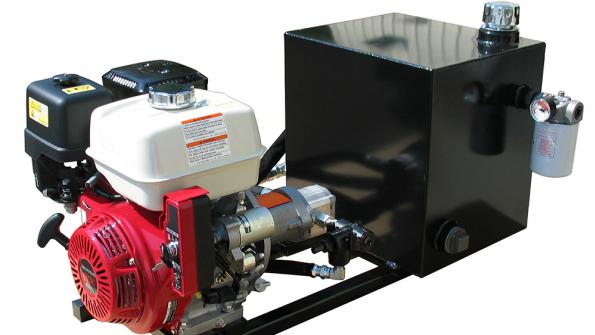

1. When a gasoline (shown here) or diesel engine will be the prime mover in driving a hydraulic power unit, sizing calculations will differ from those when using an electric motor. That’s because electric motors develop very high starting torque, whereas gas and diesel engines develop roughly the same torque throughout their speed range. (Image courtesy of York Portable Machine)
When specifying components for a hydraulic power unit, the prime mover is sized based on torque, speed, and power requirements of the hydraulic pump. This is fairly straightforward for electric motors, because they generally have a starting torque that far exceeds running torque. Often, though, designers specify motors sized larger than necessary. This results in wasted energy because the motor operates at less than maximum efficiency.
Diesel and gasoline engines are another matter. They have a much flatter torque-speed curve, so they deliver roughly the same torque at high speed as they do at low speed. This means an internal combustion engine (Fig. 1), may develop high-enough torque to drive a loaded pump, but not enough to accelerate it to operating speed. Consequently, with all other factors being equal, a power unit requiring an electric motor of a given power rating usually requires a gasoline or diesel engine with a power rating more than double that of the electric motor.

Gas and Diesel Engine Power
Correctly sizing an electric motor for a hydraulic power unit is a straightforward procedure. And if load pressure and flow remain fairly constant, determining the power requirement is relatively simple by using the familiar equation:
hp = (q × p) / (1,714 × EM)
where q is flow, gpm (and accounts for the pump’s volumetric efficiency),
p is system pressure at full load, psi, and
EM is the pump’s mechanical efficiency.
For example, assume an application requires a flow of 13.7 gpm at a maximum pressure of 2,000 psi, and with a pump efficiency of 0.80. From the equation above:
hp = (13.7 × 2,000) / (1,714 × 0.80)
     = 20 hp.
It may seem that a gas or diesel engine as the prime mover would have the same power rating as an electric motor. However, the general rule of thumb is to specify an internal-combustion engine with a power rating 2½ times that of an equivalent electric motor (Fig. 2). This is due primarily to the fact that internal combustion engines have different torque-speed relationships than do electric motors. Examining the different torque characteristics will provide the understanding to make a choice based on solid reasoning, rather than putting faith in a rule of thumb.
