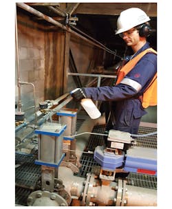

6. Determine the equipment or method to be used for leak detection. Any or all of three following options are used most often:
The human ear—This is the most common process for finding leaks, but should be conducted with caution. Many plant environments require hearing protection, which makes this method ineffective. Human hearing is often unable to pinpoint the location of a leak. Furthermore, small leaks may be inaudible even to the sharpest hearing. Yet, every one of these small leaks wastes energy. Adding up the grand total of the many inaudible leaks in a plant may produce a shocking amount of energy wasted annually. For these reasons, an ultrasonic detector is much more effective at locating and quantifying compressed-air leaks.
Spraying a suspected leak area with soapy water can verify the presence and location of a compressed air leak if bubbles continually form at the site. Experienced practitioners can also assess the severity of the leak by examining the size of the bubbles.
Liquids—Liquid detectors are inexpensive and easy to use, but they can be more time consuming than, say, ultrasonic detectors. One benefit to liquid: it can often be purchased in a low-temperature version if leak detection is done outside in colder weather. Another benefit: bubble size can help determine the size of the leak.
