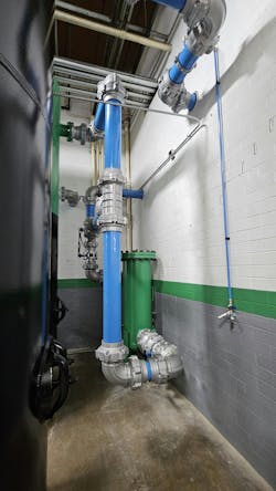

Taking these requirements in mind along with the performance needs of the facility, Pattons determined the best solution was to replace the company’s air system with new ELGi air compressors, refrigerated dryers, wet and dry tanks, and a smart controller. The products selected were those which enabled reliability and energy efficiency to be built into the system.
Five 200 hp ELGi EG-160 air compressors were installed at the facility — three with fixed-speed drives and two with variable frequency drives (VFD) that adjust motor speeds to a given load requirement. Carter explained that the VFD compressors help meet both high and low demands for flow to the system. “We’re only using energy for the amount of air that we need,” he said. “We can lower the plant pressure to an acceptable level and keep it steady with the variable speed technology.”
And because the η-V profile rotors for these compressors operate at low speeds, heat generation is reduced to prevent maintenance issues.
Three ELGi AR-2350 refrigerated dryers were installed as well to eliminate the moisture-related failures Mann+Hummel had previously experienced. The dryers are equipped with an automatic condensate drain, enabling them to remove moisture without air loss. This prevents water-related issues from occurring in the compressed air system that could otherwise cause damage to seals, cylinders and pneumatic tools, leading to misaligned and inconsistent product assembly.
