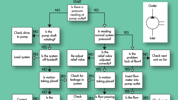

Figure 10 – Suggested troubleshooting procedures for the hydraulic systems with gear or vane pumps. Click on image for larger view. (Click on image for larger view.)

Figure 10 provides a systematic sequence of troubleshooting steps beginning with a reading of that gauge.  No pressure would indicate no flow.  The left side of Figure 10 addresses this situation.  Note that most of these checks can be made without instrumentation.  (Also note that the item on pump assembly would be a consideration only on new installations.)
If the gauge at the pump outlet registers pressure, the steps in the right-hand area of the chart should be followed.  The steps require some instrumentation – vacuum gauges and flow meters.  Note here that the relief valve and its setting may be at the root of many problems attributed to the pump.
