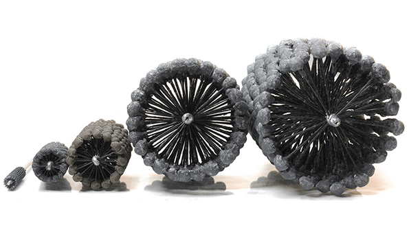

Elmar was familiar with cylinder hones, having used them in the past for manufacturing valve bodies. From time to time, they used the Flex-Hone, from Brush Research Mfg. Co., Los Angeles, in the field to hone out undersized or out-of-tolerance cylinders. The Flex-Hone is an abrasive tool characterized by small, abrasive globules permanently mounted to flexible filaments. Versatile and easy-to-use, the cylinder hone can deburr and clean out passages or provide bores with a finish free of cut, torn, and folded metal. It can also be used for edge blending, plateau honing, polishing, and chamfer operations.

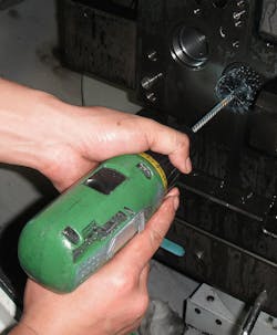

Although the Flex-Hone can be used in automated production equipment, it can also be used with a handheld electric drill. The tool is well-suited to field use because it is self-aligning and self-compensating for wear, which facilitates close-tolerance finishing work.
To assist in the repair, Dahlquist traveled to the customer’s site with several 2¼-in. Flex-Hones, valued at a total cost of less than $200. In just over four hours, Dahlquist honed each of the 45 housings to the appropriate specifications. He used a dial bore gauge to achieve the tolerance required between valve and housing. “With the Flex-Hone, drill, and a drill holder, we were able to rework each of the valve housings on the machine by hand,” said Dahlquist. “We were able to smooth out all the high points and insert the new valves.” As a result, the customer was able to begin production within a few weeks.
