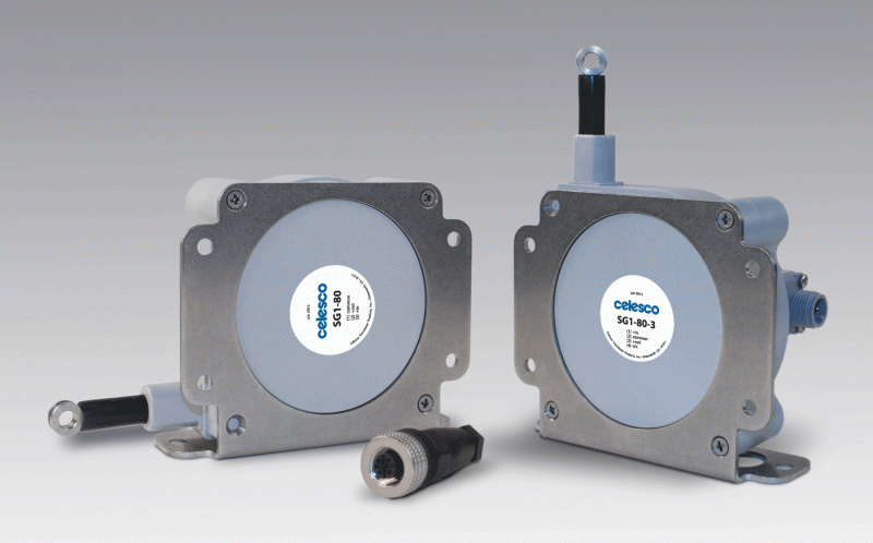

G1 stringpot comes with a 10K-ohm potentiometer that provides a voltage divider output signal proportional to spring loaded measuring cable’s position.
G1 stringpot comes with a 10K-ohm potentiometer that provides a voltage divider output signal proportional to spring loaded measuring cable’s position. It has a stroke range of 80 in.; 120-in. available soon. High-cycle plastic hybrid potentiometer and spring-loaded stainless steel measuring cable comes standard. Electrical connection options include M12 connector, a 40-in. pigtail or solder terminals directly on the SG1 pot. It offers 0.35% linearity and operates in temperatures to 160°F. O-ring sealed cover protect potentiometer in wet environments.Celesco Transducer Products Inc., (818) 701-2750, www.celesco.com
