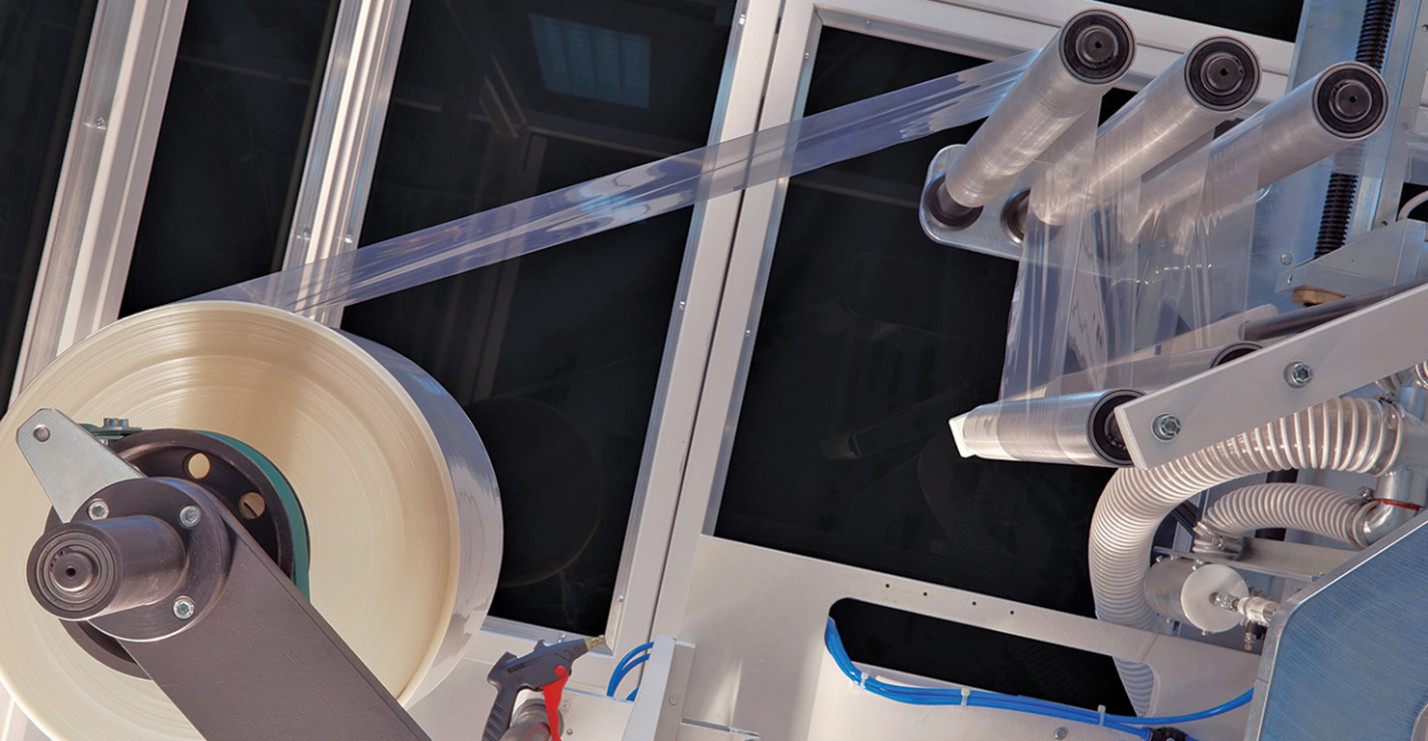

Compensating roller control—Pressure-controlled tensioning devices using EPC valves prevent lengths of fabric, plastic, paper, ribbon, etc., from tearing or getting tangled and provide an optimal material flow (Fig. 4).
4. Electropneumatic pressure regulator valves are ideal for controlling tension in roll applications by preventing tangling and tearing while optimizing flow.
