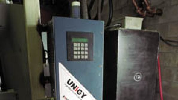

A new and different approach for a hydraulic power unit is the Unigy high-pressure pump system. Able to precisely match output pressure and flow to constantly-changing requirements, This system delivers efficiencies up 94% through its entire operating range - from zero to full flow. At the same time, it minimizes or eliminates bypass and cooling-loop requirements and their attendant complexities and costs.
The Unigy system also runs quieter than conventional pump-motor combinations. Furthermore, because its operating characteristics are not regulated via hardware, the basic Unigy system is equally applicable to a wide variety of new and existing high-pressure hydraulic systems.
Electrical drive controls pump
A Unigy system consists of a fixed-displacement pump, a 3-phase induction motor with integral drive, and computerized controls. The pump and motor both are based on conventional designs proven in literally millions of applications. But each has proprietary features that allow them to deliver performance that is outside the range of standardized, off-the-shelf pumps and motors.
The Unigy hydraulic pump can provide full pressure whether it is operating at virtually zero rpm or at maximum speed. This infinite turndown capability enables the pump to maintain pressure without flow - a characteristic that is critical to Unigy system performance.
The motor-drive has a power factor close to unity regardless of the load applied. This produces efficiency of 91% to 96% even at lowest loadings, where conventional variable-speed drives are highly inefficient. The Unigy motor consumes minimal power when operating at zero speed but transmits enough torque to the pump to maintain full system pressure.
To hold pressure under the same conditions, a conventional pump-motor would run at full power, producing full flows that require bypass and cooling to dissipate wasted heat energy. Even a pressure-compensated system would run the motor at full speed and hold pump displacement at near zero. But in this case, the pump would produce flow to compensate for internal leakage, and the motor, running at or near no load, would be operating at low efficiency.
Instead of pilot circuits, a computerized drive system digitally monitors and controls the Unigy system's performance. By collecting thousands of data points during every motor shaft revolution, the system monitors pump-motor loading, which accurately reflects hydraulic system demands. The computer, using a set of proprietary algorithms, continuously evaluates this data stream. In response to this input, the system constantly regulates current and voltage to seamlessly control motor speed and torque - and consequently, pump flow and pressure.
Likewise, Unigy pump output is precisely modulated thousands of times per second to meet exact hydraulic system demands. The results of this operational control and flexibility can be seen in the power diagrams. Excess flows (and wasted energy) have been virtually eliminated throughout a system's operating cycle. As a result, Unigy systems are capable of delivering efficiencies that can routinely exceed 90%. In production-scale applications, this has translated into overall energy savings approaching 90% for the entire high-pressure hydraulic system.
