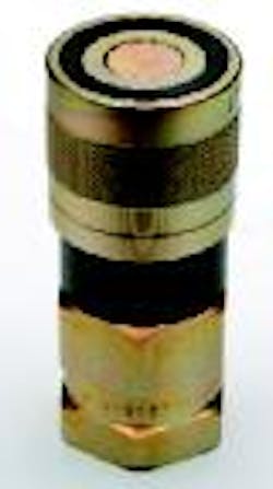

New 2FSI female kidney latch coupler for high impulse-breaker applications has 27 times more contact surface with male half than a ball latch. It is designed for flows to 18.52 gpm at temperatures of 13° to 212° F in 3 /4 in. threads and 1 /2 ...
New 2FSI female kidney latch coupler for high impulse-breaker applications has 27 times more contact surface with male half than a ball latch. It is designed for flows to 18.52 gpm at temperatures of 13° to 212° F in ¾-in. threads and ½-in. coupling size. Its maximum working pressure is 3625 psi, with the male half connectable at full pressure.Faster Inc., (800) 231-2501,www.fasterinc.com
