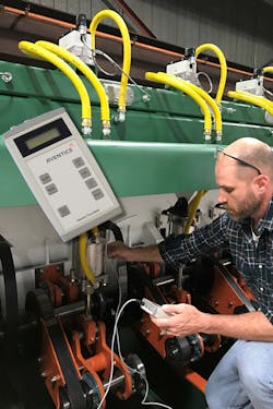

The Aventics velocity time meter (VTM), allows precise monitoring of the piston speed and cycle times, eliminating any guesswork used to set the cushioning.

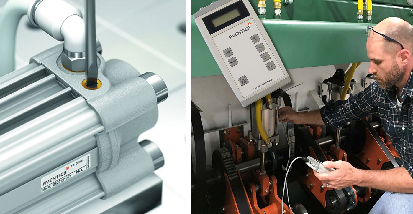

Ideal Cushioning adjustments are made with a standard screwdriver (as shown on this PRA-type pneumatic cylinder) so that the piston stops right at the end cap with zero speed.

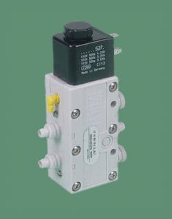

The trimmer uses Aventics Series 581 ISO directional control valves with integral flow control. This valve uses PTFE-encapsulated O-rings to reduce friction compared to standard O-rings.

Apel explains that Aventics provides a range of tools to help companies like Baxley select the right cylinder for a given application, and then easily set the cycle time and cushioning to achieve an “ideal” state: “Calculating the amount of cushioning needed is a straightforward process. The Aventics velocity time meter (VTM), allows precise monitoring of the piston speed and cycle times, eliminating any guesswork used to set the cushioning.
“The VTM is attached to the outside of the cylinder tube and enables the true velocity of the piston to be determined quickly and easily,” he continues. “Adjustments are made with a standard screwdriver to stop the piston right at the end cap with zero speed.”
The sorter machine uses Aventics Series 740 directional control valves with integrated flow control. These lightweight valves can be installed close to the cylinder, rather than on it, eliminating the need to add flow control to the cylinder and keeping weight to a minimum.
We typically set the trimmer cushioning using these tools before the trimmer is shipped to the customer’s mill. Because the sorters are assembled on-site, we provide a start-up service to configure the cylinders and ensure the cushioning is set correctly.
