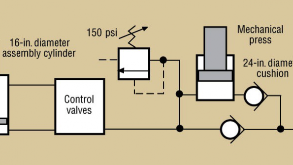

We first checked all the components in the pneumatic circuit to make sure they could handle higher pressure. We found that all were rated for 150 psi or greater so that was no problem. Then we considered adding auxiliary air or hydraulic jacks to the station but the machine’s base design wouldn’t allow us to work them in. Next we thought about a higher-pressure auxiliary compressor just for this machine but a big potential union problem on set-up and maintenance made us discard that idea.
Then we learned that a small, high-speed draw press with a 24.-in die cushion was being taken out of service in another department. The press had a 300-psi rating. Could we use it somehow?
As it turned out, we could. We plumbed the die cushion in parallel with the shop air supply to the production machine and connected a 150-psi relief valve and a couple of check valves. We next wired the electric circuit so that when the operator fired the air control valves, he tripped the mechanical press, too. The die cushion acted like a booster and gave us all the 130-psi air we needed. The time required to cycle the press was no problem because the new larger assemblies took more time at the other machine stations.
It looked a little crazy to see a mechanical press running next to an assembly line — doing nothing but displacing its cushion, but it worked like a charm for us. We eventually added a limit switch on the press to release its cylinder only after air was recovered in the cushion — making our operation very efficient, with little or no compression temperature rise.
