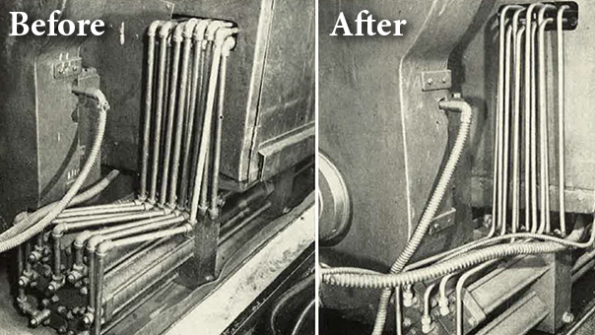

A start was made on thirteen machines—which, because they were the worst leakers, represented the most expensive hydraulic operations in the plant. After our recommendations had been accepted, we removed the heavy, patchwork piping and conglomeration of miscellaneous types of fittings in these circuits and installed completely new lines.
In addition to attaining the primary goal of leak-proof circuits, other noteworthy advantages were gained. By using tubing, more logical layouts of lines for improved accessibility of both the hydraulic system and the machine proper were possible. Tubing bends substituted for elbows, greatly reducing the number of joints. Standardizing on one type of fitting (a flared tube type of fitting was used for its leak-proof performance) simplified fabrication of the lines and made the installation uniform. Replacement of the old, bulky piping with the new "streamlined" free-flow circuits conserved space in many instances. All thirteen machines certainly presented a much neater appearance.
This re-tubing work had to be done over weekends so that production was not held up. In rebuilding a machine's hydraulic system, only as much old piping was removed as could be replaced during the weekend working hours. Some of the more complicated jobs required three week-end work periods. One of our representatives was on hand each Monday morning to make sure that the remodeled circuits operated to satisfaction under continuous production conditions.
The improvement in the operation of this original group of machines convinced the plant production officials of the wisdom of their revitalization program. Plans were approved to systematically rework all their hydraulic equipment. To date, approximately 125 machines have been so improved. These include various makes of many kinds of machines—grinders, milling machines, drills, automatics, broaches, honing machines, pad mills, crankshaft machines, drill presses, welding equipment, and others.
