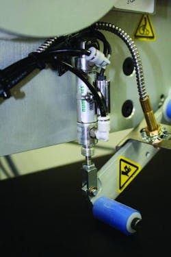

A pneumatic cylinder generates the pressure necessary to transfer adhesive onto the passing product, then retracts to eliminate drag.
Pressure is necessary to transfer the adhesive from the web onto the passing product. Because of this, only brief contact with the product is permitted to eliminate any drag yet still facilitate transfer.
Extending and retracting the application roller onto and away from the customer's product becomes extremely important.

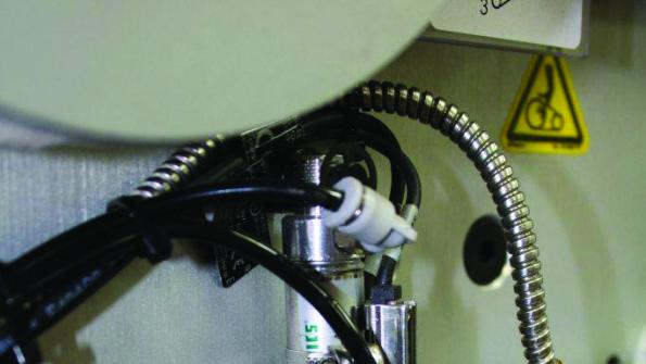

  • Pneumatic cylinders, such as the one on the SD-900, can come with internal magnets. Thus, technicians can easily mount low-cost external sensors to detect end-of-travel limits.

The double-acting Numatics cylinder used on the SD-900 has a 0.56 in. diameter, bumpers at both ends, and a rear pivot mount. It's made of aluminum and stainless steel and is pressure rated to 250 psig.
