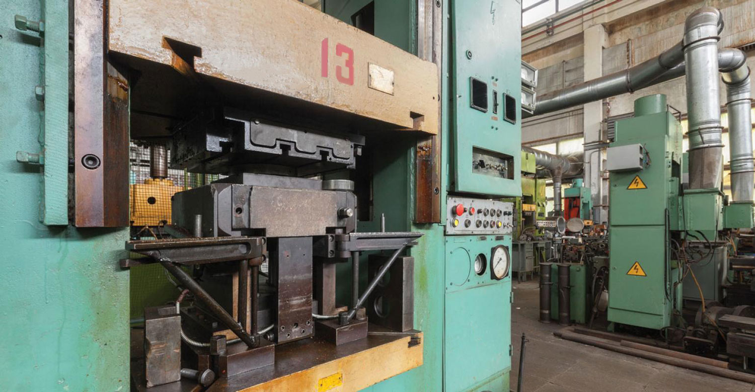

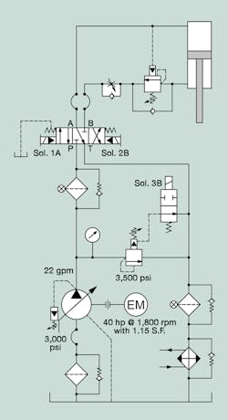

Technicians were performing preventive and predictive maintenance inspections of a press and noticed a noise change in the hydraulic unit’s piston-pump. It sounded like a knocking noise that had a 30-Hz (30 knocks per second) signature. The workers checked the pump’s case-drain flow when the pump compensated, but it had not changed since the last inspection. Oil sampling and analysis revealed that the fluid’s ISO 4406 code was better than the system required.
We asked them what, if any, service was performed recently. They had changed the return filter element when they had to replace the pump’s suction hose that someone stepped on and kinked. The work team felt the damage warranted changing the hose.
A schematic of the hydraulic system is shown. If it looks familiar, it’s because a previous Troubleshooting Challenge dealt with a problem on this same machine, where a solenoid sticking on an electrically unloading relief valve prevented the electric motor from being able to start the power unit’s hydraulic pump.
Any idea what was causing the knocking noise in the pump?
