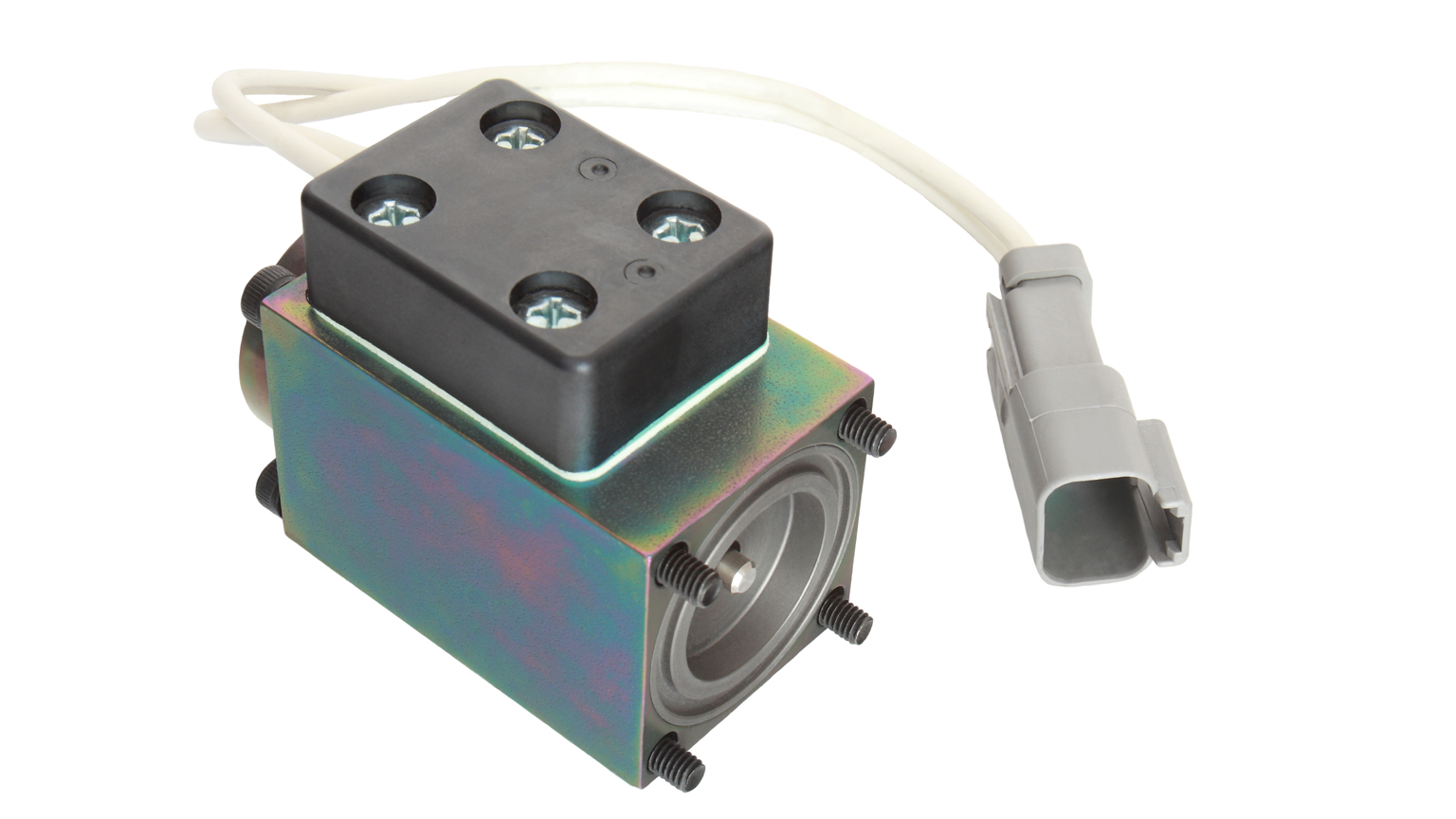

Issue 1: Overheating
When a solenoid is first energized, its coil receives a pulse of high inrush current that decreases as the plunger closes. If the plunger does not close, the high inrush current continues, which can cause the coil to overheat and burn out. This is the most common cause of solenoid failure and spotting it is easy.
When a coil burns out, the nylon bobbin upon which it is wound melts and runs into the air gap under the plunger. If you find melted bobbin material, see if the plunger was mechanically blocked open. On a double-solenoid valve, see if both solenoids were energized at the same time. (Magnet wire insulation wire may burn too).
Standard coils are rated class 105°C (221°F), so they can safely reach and sustain temperatures slightly hotter than boiling water. Thus, a solenoid too hot to touch may not be overheated.
A drop in supply line voltage can prevent a solenoid from closing by reducing its force until it can’t overcome the load’s resistance. Check the line voltage over a 24-hour period.
If ambient temperature is too high, the coil’s ability to dissipate heat by radiation is reduced. An overheated coil’s resistance increases, current flow and force are reduced, and the solenoid will not close, resulting in coil burnout again.
Check the cycling rate. If a solenoid cycles too fast, heat will build up faster than it can be dissipated. The solenoid becomes too weak to close, so it receives a continuous high inrush current and burns out.
