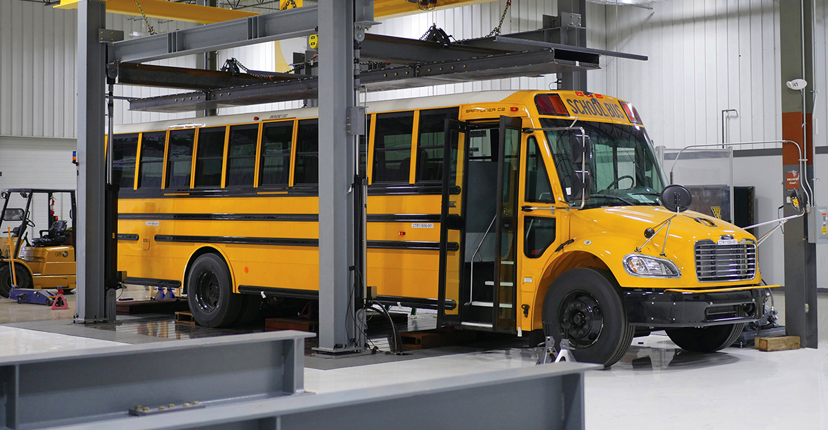

The test system uses four hydraulic cylinders mounted at the four corners of a heavy-gauge pressure plate (Fig. 2) and controlled as four separate motion axes. Cylinders—each with a 6-in. bore and 48-in. stroke—from Parker Hannifin were chosen and are operated by Parker D1FHE80 proportional directional valves rated for flow to 20 lpm and each mounted to a manifold right on each cylinder. “The valves feature spool-bushing construction with zero overlap and fairly high frequency response, making them an excellent fit for this project,” says Hoover.
2. The CAPE roof crush test rig operates with hydraulics cylinders at each corner of a pressure plate. The photo at top shows a school bus in the test rig, and at bottom the test rig set up for the body of a wildfire-fighting apparatus.

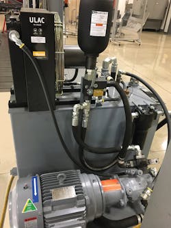

The test machine’s hydraulic power unit (Fig. 3) uses a 2.75 in.3/rev piston pump and a 0.85 in.3/rev gear pump driven by a 15-hp electric motor at 1,800 rpm. Maximum operating pressure is set at 2,500 psi.
3. The hydraulic power unit of the testing system uses a variable-displacement axial-piston to generate pressures to 2,500 psi in a work cycle.
