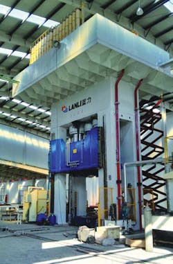

1. The 3,000-ton press manufactured by Wuxi Lanli Machine Tool Co. Ltd. of Jiangsu, China.
Wuxi Lanli Machine Tool Co. Ltd., Jiangsu, China, a hydraulic press manufacturer, was challenged with improving the operation of an older press design to produce body panels (Figs. 1 and 2) for a Chinese auto plant. With three main compression cylinders, the hydraulic press could easily handle the tonnage required for the new application, but there were issues with keeping the platen perfectly level as up to 3,000 tons of force were being applied.

The forming cycle is controlled by a PLC, which operates the three main compression rams, and provides a target position and maximum force value to the Delta motion controller for use in controlling the four 100-ton cushioning cylinders. The cushioning cylinders “catch” the platen as it descends, and apply a resistant force at each corner in order to keep the platen level during the forming operation.
“The press uses two separate systems: the three main cylinders on the top, controlled by an Omron PLC driving servo pumps, and the four cushion cylinders, controlled by the RMC driving Parker D30FP servovalves,” explains Henry Xie, Wuxi Forever sales manager. “With the Delta motion control system in place, Lanli faced two main challenges in the design of this press. First, how to make the upper platen and lower cushioning hydraulics work in concert; second, required accuracy of leveling position was very high (less than 0.05 mm).”
