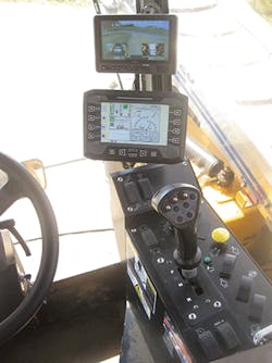

The Danfoss Plus+1 system not only controls hydraulic functions, but monitors operating conditions and provides the operator with easy-to-read displays and fingertip control.

Implemented across the Oxbo fleet of vineyard harvesters, the current Plus+1-developed operating system gives the operator control over a much broader set of machine features, and takes some of the guesswork out of maximizing machine control for the most efficient operation. The Oxbo 6000 product line utilizes Danfoss electronic controls that include 50-pin controllers, I/O expanders, and a DP700 display, making machine control intuitive to the operator.
In today’s vineyard harvesters, the Plus+1-integrated hydraulic system offers control over end-user functions such as automatic height and leveling control, automatic picking head speed control, automatic steering control, and ground drive speed control. These capabilities are expected to expand.
