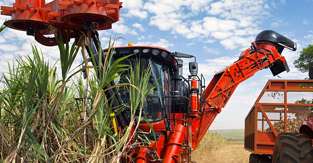

GMS completely restructured the hydraulic system by switching to a variable-displacement open-circuit solution, using P1 Series pumps with Electronic Displacement Control (EDC) and F12 Series bent-axis piston motors. Parker’s P1 variable-displacement pumps have maximum displacement of 140 cc/rev (8.5 in.3/rev) and maximum flow of 278 lpm (73 gpm) at a max speed of 2,000 rpm. Maximum operating pressure is 280 bar (4,000 psi).
The F12 bent-axis, fixed-displacement motor features a proprietary spherical piston design that which provides high efficiency, speed, and acceleration capabilities. The result is high power density with reduced heat generation. The F12 motor is used on the fan blower to not only direct air through the machine’s radiator, but also to convey leaves and stripped chaff out the rear of the machine. The F12 motors accommodate pressures to 480 bar (6,960 psi) and produce output speeds to 7,300 rpm. Gear synchronization and double-tapered roller bearings provide robust and reliable operation in demanding applications for both open- and closed-loop systems.
This compact electronic solution reduced system complexity and increased efficiency, which reduces operational costs over the machine’s lifetime. Open-circuit EDC was chosen because a closed-circuit system would have required a charge pump and the losses associated with it as well as extra components needed for load sensing. The EDC hydraulic system also reduces the number of potential leakage points while providing better pump response and onboard diagnostics. Multiple P1 Series pumps were incorporated into the hydraulic circuit for different functions, including the primary extractor, base cutter, and fan drive.
