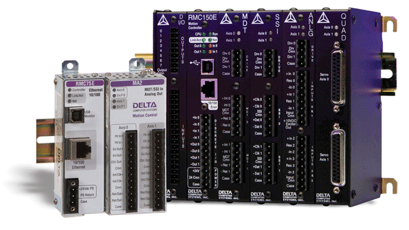

High-performance motion controllers can simultaneously control several motion axes, moving independently or in relation to one another. Some can even select, on the fly, between multiple feedback devices to extend their range of operation (if the feedback devices have different ranges of sensitivity), or protect against the adverse effects of feedback device failure (if redundant feedback devices are used). Delta Computer Systems’ RMC family of motion controllers, for example, can tightly coordinate up to eight motion axes simultaneously and handle a wide range of feedback options, including mathematically calculated feedback values.
