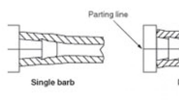

Many fittings have two, three, or more barbs. The apparent reasoning is that if one barb holds well, two will hold even better. However, this reasoning often does not hold true. Even this simple aspect of fitting configuration can greatly affect the success of an application. Here's why: Due to the shape of a barb, only the first barb on a fitting can be produced on injection molding equipment without a parting line. Any additional barbs must have parting lines, otherwise, the fitting could not be removed from the mold.
The discontinuities of parting lines create potential leak paths, and parting lines become more pronounced as the production tooling wears. Thus, multi-barb fittings have an inherently higher likelihood of leakage.
Two other problems exist with multiple-barb fittings. First, it is impossible to fabricate tooling that creates a perfectly sharp peak on each barb of a molded multiple-barb fitting. Because it occurs at the mold parting line, only the first barb can have a sharp peak; subsequent barbs have rounded peaks as a result of the machining or EDM process used to form the barbs in the mold. Sharp peaks are critical to the performance of the connection. Second, multiple barb fittings may not be spaced far enough apart to allow the tubing to relax behind the first barb. If the tubing bridges from barb to barb, there is no uninterrupted interface with the fitting. This condition can compromise the pressure and tensile capacities of the connection.

The best practice is to have the fitting manufacturer supply a barb design with the best combination of sealing integrity, high pull off strength, and low assembly force for the type and size of tubing that will mate with it. A well-made single-barb design has no parting line and a sharp peak on the barb, allowing it to bite into the tubing. Then the cylindrical surface behind the barb allows the tubing to relax against the fitting.
