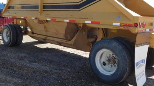

Pneumatics is ideal for actuating bottom-dump trailers because operators can control the rate at which material is dumped without usig a lot of expensive and delicate electronics.
Bottom-dump trailers have opposing hinged doors located beneath their beds. To unload material from the bed, these doors are opened with a set of large air cylinders. By feathering the valve that controls the cylinders, the driver can position the doors to throttle the delivery of the material while he or she drives the truck. Or an operator walking alongside the vehicle can operate the doors from that vantage point. Bottom-dump trailers often are used for long stretches of road construction because this door configuration and control allows them to deposit material evenly as they travel.
The air valve that manipulates the doors is typically a 3-position, blocked-center model. There are a number of designs available, but they must all provide that the doors can be opened or closed or maintained in a given position. The valve must be capable of being operated with an electrical signal from the driver's cab or manually from an external station.
