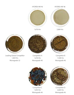

Another important test for hydraulic fluids is ASTM D943. In this standard industry test, again, 99.5% oxygen flow, high temperatures (95° C), and copper and steel catalysts were used to accelerate oxidation to determine the rate of acidity buildup in hydraulic fluids. Petro Canada’s Hydrex AW and oils from other suppliers were subjected to this test. Later, fluids were filtered and sludge samples examined. The Hydrex AW had significantly lower sludge formation than the other oils — even after the Hydrex AW was tested for a longer duration.
