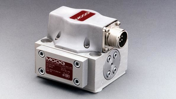

Hydraulic servovalves can run for as long as 25 years. But why do they perform for so long, even in demanding applications like steelmaking and industrial production machinery?
The hydraulic servovalve is part of a closed-loop control system including electromechanical mechanisms and embedded software algorithms. The design, materials of construction, manufacturing processes ensure that it will maintain consistent performance over its expected lifetime.
More than ten years ago Moog introduced a hydraulic servovalve with a carbide ball to replace the traditional steel material used for decades. Although most manufacturers have defined long life as millions of cycles, but engineers at Moog recently offered an even higher standard: above one billion cycles.

After one billion test cycles, the stainless steel ball exhibits visible wear (left), whereas carbide (center) and sapphire do not. The carbide material also has the advantage of enabling the feedback mechanism wire to be bonded through a brazing process. This provides even greater reliability in industrial environments.
Carbide ball construction
Despite using precision machining processes over the years, Moog's servovalve designers discovered that premature wear of the ball in the feedback mechanism degraded the valve’s performance. Most early designs incorporated a stainless steel ball on the feedback mechanism that would wear out over time. Since the 1990s, carbide and sapphire materials have been introduced to replace stainless steel and provide extended protection to the ball.
Moog G761 Series servovalve cutaway showing ball-in-hole design..
Although sapphire is more expensive than carbide, it does not necessarily offer higher performance. In fact, engineers at Moog have evaluated the wear characteristics of a ball made of steel, carbide, and sapphire by subjecting each to one billion test cycles in a controlled environment with clean hydraulic fluids and temperatures held at a steady state. While the stainless steel ball revealed significant wear, the results confirmed that a carbide ball and sapphire ball did not show any signs of wear. In addition to being comparable in performance to sapphire and less costly, carbide material can also be bonded to the feedback mechanism wire by brazing. For cost control, carbide is the clear choice for ball design.
