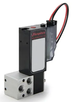

Model HKL5 direct-acting solenoid valve offers 0.05 CV flow rate, 1.8 W power consumption, vacuum to 30 psig pressure rating, and 32° to 175°F working temperature range. Porting configurations allow it to be used as a 2-way or 3-way, NO or ...
Oct. 9, 2008
Model HKL5 direct-acting solenoid valve offers 0.05 CV flow rate, 1.8 W power consumption, vacuum to 30 psig pressure rating, and 32° to 175°F working temperature range. Porting configurations allow it to be used as a 2-way or 3-way, NO or NC standard fill/exhaust valve, or as a selector or diverter. Isolated coil offers minimal armature travel for a fast response time of 0.010/0.004 msec, and is available in 12 or 24 Vdc coil voltages.
