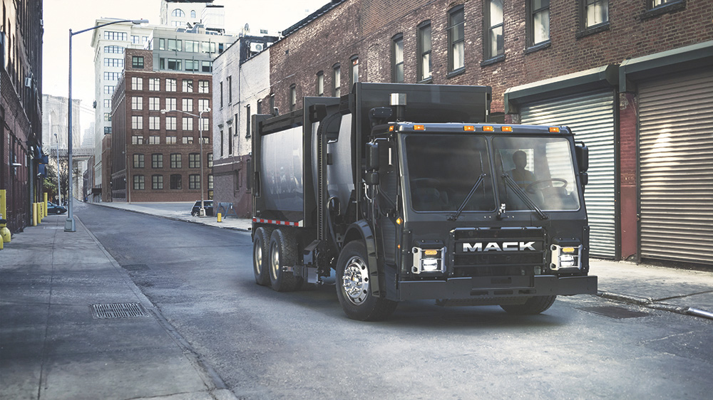

Mack Trucks, Greensboro, N.C., announced plans at this year’s Waste Expo to have a fully electric Mack LR refuse model equipped with an integrated Mack electric drivetrain operating in North America in 2019. The New York City Department of Sanitation (DSNY), one of Mack’s largest customers, will test the demonstration vehicle in its highly demanding operations.
“The fully electric Mack LR model will feature an electric motor feeding power through a two-speed transmission and a propeller shaft to the rear axles,” explains Curtis Dorwart, refuse product manager at Mack Trucks. “All accessory power needs—including the hydraulics—will be driven on demand by auxiliary motors with power supplied by the truck’s lithium-ion batteries.” This continues a growing trend in mobile hydraulics to drive a machine’s hydraulic pump with a variable-speed electric motor, thereby transmitting only that power needed for the task at hand—with zero power consumption while the hydraulic system is idle.
