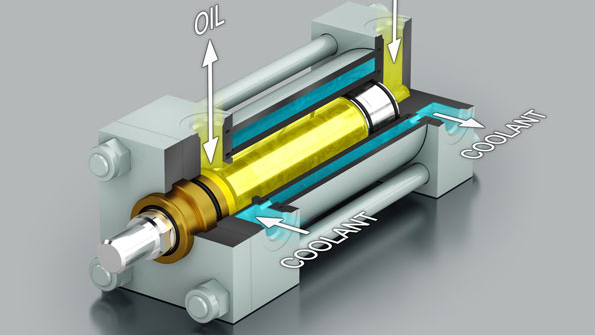

Fortunately, most cylinders don’t have to operate under conditions this extreme. But when they do, Milwaukee Cylinder, Cudahy, Wis., offers its Vulcan Series of standard and custom water-cooled cylinders. The cylinders contain a cooling jacket in which coolant circulates to maintain reasonable temperatures. Cooling the cylinder barrel, though, may not be enough. Therefore, Milwaukee Cylinder also offers cooling jackets for rod bushings, which provide cooling primarily for the rod bearing and rod seal. This solution proves especially useful if the piston rod is exposed to extreme heat while it is extended. When the rod retracts, it becomes a heat source within the cylinder.
Water-cooled cylinders rely on a source of cooling water that absorbs the ambient heat energy and moves this energy away from the cylinder, protecting the cylinder components from exposure to high temperatures. The term, water, though, is a bit of a misnomer.  Instead, any of several industrial coolants are used that are not corrosive and that have better heat transfer properties.
