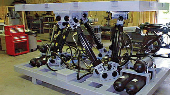

Sizing and power requirements
Proponents of electromechanical motion bases repeatedly claim that electrical systems consume less power than hydraulic systems do. Let’s see if this is true through an example, which is summarized in the accompanying table.
Assume we need to lift and hold a 20,000 lb payload for extended periods of time. This is a common condition for flight simulators and similar applications where accelerating and decelerating dynamics are small, but large excursions of the platform are required. Such applications typically use six linear actuators arranged in a hexapod configuration.
As indicated by the table, the installed power requirement is 20% more for an electric motion base system, and consumption is greater. The most telling issue is when the motion base operates near its mid-stroke position, with no motion being commanded. In this case, the hydraulic valves feeding the cylinders close, and the variable-displacement pump in the hydraulic power unit (HPU) throttles to near zero displacement. This allows the HPU’s motor-pump to operate in a low-energy consumption mode. The electromechanical unit, on the other hand, must continue consuming energy equal to the entire weight of the payload, generating heat.
In this case, the hydraulic system generates heat that requires about 3.2 tons of refrigeration (38,000 btu/hr or 11.1 kW) to stabilize temperature. However, the electric unit generates heat requiring 13 tons of refrigeration (156,000 btu/hr, or 45.7 kW). This cost of heat rejection cost is rarely mentioned by those promoting electrical systems. This point is important because electrical systems are air cooled, so the generated heat migrates to the surrounding environment, typically occupied by people. Hydraulic systems reject less heat, and that heat can be dissipated in a separate room through an air- or water-cooled heat exchanger or directly to atmosphere.
This point should not be trivialized because users may have to install expensive cooling systems after they discover the higher temperature of the room housing the electric motion base. The bottom line is that electromechanical systems used in typical motion bases consume significantly more energy than electrohydraulic systems do.

Electromechanical motion bases require high voltage transmitted to their actuators. Special precautions need to be taken to ensure such systems are safe and meet national and code requirements. Hydraulic systems, however, only require high voltage service at a remote HPU. It is common for the hydraulic HPU to be located in a room with limited access. Hence, only low control voltages are required directly at the motion base.
Hydraulic systems require pressurized hoses routed to each of the actuators under servovalve control. Typically system pressures run from 1000 to 1500 psig. These pressures are easily and safely handled by two-wire-braid hoses commonly rated for working pressures to 3000 psig and burst pressures well above that. Leaks are virtually eliminated by using SAE O-ring, JIC, and other modern fitting configurations. And if environmental issues are a concern, any of several “environmentally friendly,” or even food grade hydraulic fluids can be used.
