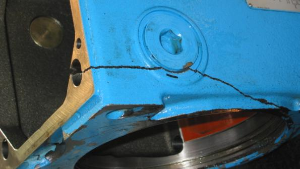

A while back I posted this picture of a cracked, hydraulic piston-pump housing on my Facebook page.
One of my FaceBook Friends made the comment that for this to happen, the pump's rotating group would have to have failed and come apart in a spectacular way. Not so. And based on my long experience in the hydraulics repair biz, this being the cause of a cracked housing is a rare occurrence indeed.
But a cracked pump or motor housing due to a restricted (or blocked) case-drain line is far more common than you might think. Of course, if you forget to connect the drain line
in the first place, you effectively turn the pump or motor housing into a pressure vessel -- something it's not intended to be. Bang!
Similarly, if you connect a flowmeter into the pump or motor case drain line, to measure internal leakage, but forget to open the loading valve, this has the same effect: the housing fails spectacularly shortly after start-up. Don't laugh, I know of instances where this HAS happened.
But there's another all-to-common restriction to the drain line that can result in a cracked housing: filters. If there's a surge of leakage into the pump or motor case, and it can't escape due to the restriction of the filter, the resulting pressure spike CAN crack the housing. Or blow out its seal. But even if it doesn't have this dramatic effect, the presence of a filter in a piston pump or motor case-drain line often results in excessive case pressure. And high case pressure causes seal failure and mechanical damage.
