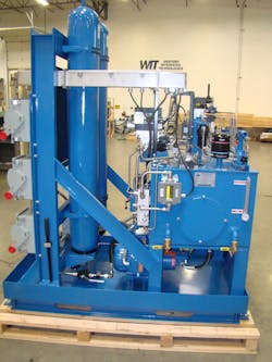

Two hydraulic-power units slated for use in a hydro-dam project at Colorado’s Carter Lake will integrate a smart system to optimize flow rate through the dam’s wicket gates. Design of the hydroelectric generators is being handled by Gilkes, a UK-based manufacturer of Francis-turbine hydroelectric generators. Western Integrated Technologies (WI), a Parker Hydraulics systems integrator, supplied parts and services related to the generator’s smart-monitoring and flow-control elements.
2. This picture shows the hydraulic system with its accumulators. (Click to enlarge.)

3. Manifolds were customized with Parker fittings to prevent leaks. (Click to enlarge.)
Custom-designed manifolds integrate Parker cartridge valves, including hydraulic-system check valves, relief valves, and unloading valves. Parker test points provide individual pressure monitoring for certain functions, and Parker electronic pressure transmitters/switches are used for pressure monitoring and lead/lag motor pump control.

To keep the hydraulic oil clean, a Parker’s WPF pressure filter will be installed at the inlet of the power unit; oil will then be recycled through a low-pressure tank top return filter. A desiccant breather will be used to remove moisture from incoming air. To further protect the interior from moisture, the power unit is plumbed with stainless-steel tubing; interconnections feature Parker ALok fittings to secure piping and fittings and prevent leaks.
