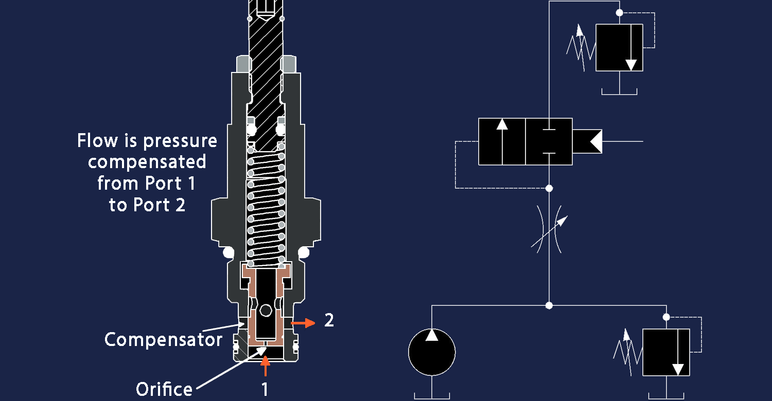

In our scenario, the compensator valve is upstream of the orifice, but you could actually place it downstream, and it would work just the same. In my opinion, moving the compensator downstream does, actually, qualify it as a post-compensated system (albeit not suitable for flow sharing, which is another discussion), but it doesn’t change that it still obeys the same principle. It is still a biased-open flow limiter, in which the compensating pressure drop across the metering element is defined by the spring (Fig. 3).
3. Placing the compensator valve downstream of the orifice causes spring force to determine the compensating pressure drop across the metering element.
The post-compensated, normally open flow control arrangement is often found in fixed-orifice, cartridge-style flow-control valves because it is the simplest (and least expensive) construction. It consists of a single spring-biased spool with an orifice in it (Fig 4).
4. The post-compensated, normally open flow-control arrangement is often found in fixed-orifice, cartridge-style flow-control valves.
