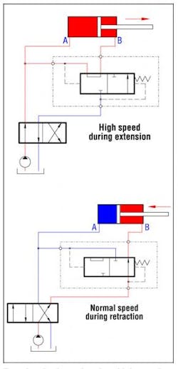

Speed valves allow easy incorporation of flow regeneration into circuits simply by connecting the valve’s three ports between a double-acting hydraulic cylinder and directional control valve.
Scanwill SV series speed valves make it simple to produce regenerative, double-acting hydraulic cylinder performance by adding a standard component to a conventional circuit. Manufactured by Scanwill Fluid Power ApS, Albertslund, Denmark, speed valves are piped between a cylinder and its directional control valve. A pilot-shifted spool interconnects the cylinder’s A and B ports for high-speed, low-pressure regenerative extension. When the circuit’s main directional control valve commands the cylinder to retract, the spring and pilot signal at the opposite end of the speed valve automatically shift it to send flow out of the A port directly to tank.
Functional schematics show high-speed, regenerative extension and normal-speed retraction using Type SV speed valve.
Rated for pressures to 500 bar, four SV series models handle flows of 40, 50, 120, and 200 lpm. They suit new installations or retrofits. These compact units are only 115-mm long and 35 mm in diameter. All fluid connections have 3⁄8-in. BSP threads. Speed valves do not affect cylinder retraction.
