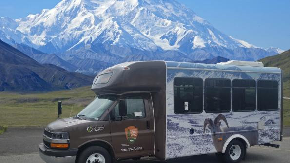

Park officials employ clean-energy hybrid shuttles to transport park visitors up to the top of Mount Denali. Formerly known as Mount McKinley, it is the highest mountain in North America.
Denali National Park recently took delivery of two buses that rely on hydraulic hybrid technology to conserve fuel and cut emissions while operating in the 6-million-acre park.
Mount Denali (formerly known as Mount McKinley) is the centerpiece of Denali National Park, and with good reason: At 20,310 ft., it is the highest point in North America. Park officials recently took delivery of their first two hydraulic hybrid vehicles from Colonial Equipment Co., a leading provider of commercial buses, coaches, and vans.  The shuttle buses will transport park visitors along a 14-mile paved section of the scenic 92-mile long Denali Park Rd.—the only road in the 6-million-acre park. It runs parallel to the Alaska Range and travels through low valleys and high-mountain passes.
