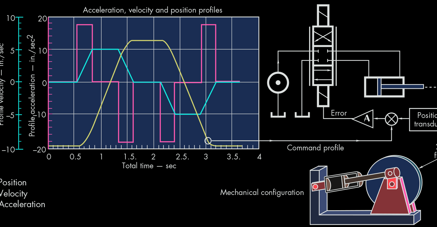

The instantaneous pressures in the two ends of the actuator are interesting because they reveal peculiarities in the hydraulic servo system. To demonstrate the characteristics of a motion-control system, we will examine test results of a valve-controlled cylinder in a closed-loop, positional servomechanism (Fig. l).
The mechanism was designed for special electrohydraulic motion-control training programs using a cylinder with a 2-in. bore, 1 3/8-in. rod diameter, and 6-in. stroke, and a magnetostrictive linear displacement transducer for position feedback. The load is a 4-in. thick, 16-in. diameter, 250-lb flywheel. The flywheel produces an equivalent mass at the cylinder rod of approximately 1,500 lb when the 3.5-in. torque arms are perpendicular to the cylinder rod. The cylinder is connected to the flywheel in a cranking fashion, as shown at the lower-right of Fig. l. This combination produces a natural frequency of about 20 Hz. The constraints of the cranking mechanism limit the maximum stroke of the cylinder to just under the full 6 in.
Cylinder motion is controlled using a PC equipped with a general-purpose data interface with analog input and output. Acceleration, velocity, and position profiles are also shown in Fig. l. The motion-control profile was synthesized on the PC using the Profile Synthesizer module in the VCCM repertoire of computer programs. Only proportional control was used; no integral or derivative control was used.
1. Position, velocity, and acceleration profiles, left, are used to command a servomechanism though its entire cycle. A schematic representation of system is shown at upper right, and a simplified drawing of the mechanical configuration is shown at lower right. An initial dwell (velocity is zero) of 0.6 sec. occurs at the beginning of the profile. It is followed by a 0.28-sec. period of constant acceleration at 18 in./sec.2. Next comes a 0.5-sec. period of constant speed at 5.1 in./sec (covering about 2.5 in. of cylinder travel). The end of extension is marked by a 0.28-sec. deceleration, followed by a 0.5-sec. dwell. The retraction portion of the cycle is symmetrical; however, it terminates with a final dwell of about 0.5 sec.
Even though Fig. 1 shows three profiles, only the position profile serves as the command. The computer serves merely as an arbitrary function generator. It holds the data that describes the point-to-point values of the position command profile and provides a “moving target” to stream the profile data to the feedback (servo) loop. The command profile is nothing more than a motion plan, giving the servo something to follow. However, the actual motion of the cylinder will be merely a close approximation of the command profile.
The PC logs and keeps track not only of where the cylinder should be at every moment, but also where it actually is, its actual velocity, and the instantaneous values of cap- and rod-end pressures. How closely the cylinder’s actual motion matches the motion command is the subject of this study. The difference between command and feedback is the error signal, which is the numerical difference between the command profile and the feedback signal at every instant in time.

2. Color-coded plots show head- and cap-end pressures as cylinder strokes through cycle.
