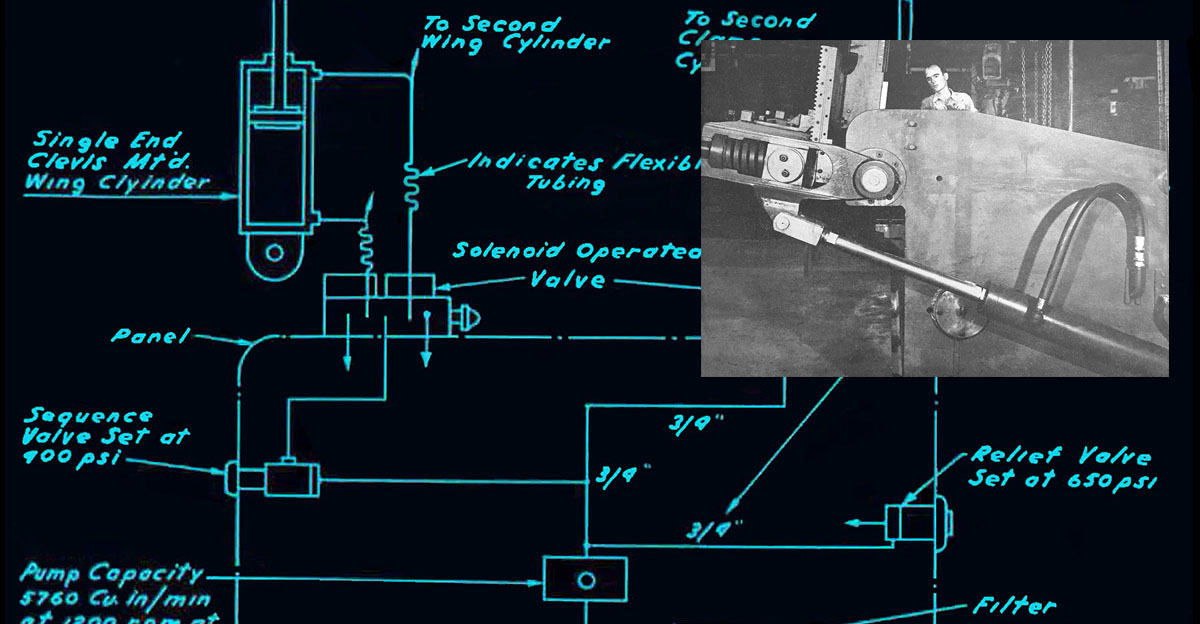

To illustrate the gain in power in the shift to hydraulic operation while also considering the reduced floor space, let us examine the power of two cylinders: first, the 5¾-in. clamping cylinder on the single-wing tangent bender (Fig. 2).
2. The hydraulic circuit of the basic single-wing tangent bender. Operation is by 4-way solenoid-operated valves. A sequence valve completes the cycling control. Note that all branch lines have sections of flexible tubing.
At 1,000 psi, this cylinder exerts a clamping force of approximately 26,000 lb. Through the leverage of the swinging arm assembly movement, the clamping pressure is multiplied to 52,000 lb before the die action starts. To accomplish the same result with air at 100 psi would require a cylinder with an 18¼-in. bore. Next, the cylinders that operate the wings have a bore of 3½ in., and at 1,000 psi, they exert 9,600 lb wing thrust on each wing, which has two cylinders. An air-powered machine would require cylinders with an 11-in. bore. Variation in stock thickness is not a problem with hydraulic operations. This is because automatic compensating-type dies may be used to address commercial variation in the gauge of the material. Therefore, production is continuous with sheets as supplied.
3. A single-wing Tangent Bender from the operator's side of the machine. The job is a "wrap-around" operation; four 1½ × 1½ × 3/16-in. angles are being formed simultaneously.
Hydraulic power is supplied from a compact, self-contained unit, designed and built exclusively for these machines by a leading manufacturer of hydraulic equipment. The unit is mounted within the machine housing. The diagram represents the functional elements of the hydraulic system for the single wing machine.
The hydraulic circuit in the double-wing machine functions as follows: With work loaded in the dies, the main ram is brought forward at rapid traverse; the automatic two-volume circuit shifts from rapid traverse to slow or high-pressure traverse as the work is contacted; the wing cylinders are then brought forward, either individually or simultaneously and perform the bending operation or operations; the wing cylinders and the ram cylinder retract in turn. A carriage cylinder turns the carriage 90 degrees, freeing the finished work for unloading. In the single-wing design (Fig. 3), the last movement of the ram retraction turns the swinging wing assembly through a 90-degree turn to accomplish the same purpose.
