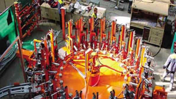

The circular conveyors of a typical filling plant are fitted with eight to 36 filling stands. The cylinders are inserted, transported, and removed automatically. The gas distribution system is situated in the center of the circular conveyor. This is where the butane, propane, or other gas flows through tubing to the individual filling stands. The gas cylinder valves can be automatically or manually connected and opened, removed and sealed.
Siraga uses at least 40 pneumatic cylinders from Bosch Rexroth in each of the filling installations. These cylinders are used to center the gas bottles prior to and during filling and remove them from the conveyor after they have been filled.
Safe and standard
Because it is imperative that no positioning problems occur when handling the liquid gas, one cylinder is dedicated to every filling stand as safety precaution. Furthermore, a pneumatic cylinder also opens the fill valve on each gas cylinder. Siraga also compensates for the different bottle sizes within the circular conveyor by using pneumatic cylinders.
As with most components of the circular conveyor, standard pneumatic cylinders are specified. This enables an installation to remain in operation by avoiding delays from hard-to-find components. Most ISO cylinders used in the design are double-acting to enhance speed and control and are fitted with magnetic sensors for electronic position sensing and control. Most also incorporate pneumatic cushioning to promote component longevity.
