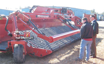

View of merger in transport mode shows how hydraulic cylinders control position of crop rollers. The Hall-effect LDT can be seen on the underside of cylinder barrels. Contributors Landon, left, and Taylor are shown at right. (Click on image for closeup view.)

In the new merger, closed-loop hydraulics is used to keep the gap constant. This is accomplished with pairs of hydraulic cylinders that contain linear displacement transducers (LDTs) for position feedback. The LDT of one cylinder sends a signal to the merger’s electronic control to indicate elevation of the head. The control processes this signal and sends a signal to a cylinder controlling elevation of the crop roller. Feedback from this upper cylinder allows the control to maintain a consistent gap between the two machine elements. The cylinders are supplied by Energy Mfg., Monticello, Iowa, and are fitted with LDTs from Rota Engineering, Manchester, U. K.
A different approach
Rota Engineering’s design of LDT eliminates the need for a gun-drilled piston rod. It uses Hall-effect technology to sense the position of a magnetic piston through the barrel of a cylinder. A linear Hall-effect sensor positioned along the length of the cylinder barrel detects the position of the cylinder’s piston by sensing the position of a magnetic field formed by a permanent magnet embedded in the piston. As the piston rod extends or retracts, the magnetic field propagates through the cylinder wall to communicate with the linear Hall-effect sensor.
