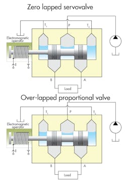

Q: What is a valve overlap?
A: Valve lap, or valve overlap, refers to the amount of spool travel from the center position required to start opening between the powered input port and the work (output) port or the tank port. A zero lapped valve is one in which any tiny, differentially small amount of spool shift, either way, starts the opening. However, there is no contact between the OD of the spool and ID of the bore. And even zero lapped valves have some slight amount of overlap. Nonetheless, the zero-lapped term persists.
Q: Why is valve overlap the single most important discriminator between servo and proportional valves?
A: Simply put, the MSOE study designated servovalves as having near-zero overlap and proportional valves as having significant overlap. Therefore, a so-called zero-lapped valve can be given servovalve status and still accommodate normal manufacturing tolerances because it allows up to 3% overlap. Furthermore, you can rarely distinguish any system performance degradation caused by that slight amount of overlap. In fact, some amount of overlap is desirable because it reduces the amount of spool-to-bore leakage.
Whenever performance specifications contain requirements of a specific accuracy, a servovalve is probably going to be required. For example, a user may have a requirement that a cylinder must have total travel of 24 in. while propelling a 10,000-lb. load at a speed of 15 in./sec, and must achieve a final position with an error not to exceed 0.020 in. This kind of performance specification begs for a servovalve and motion control design methodology.
The most accurate systems are called null seeking. This means that when the controlled output—say, the position of a cylinder—is in the desired position, the valve spool is near its center position. To achieve great accuracy in positioning, any small disturbance of the cylinder’s position (caused, for example, by a change in external load) must be immediately counteracted by a commensurately small move in the spool to overcome the disturbance. Such null-seeking operation is also required in many pressure control systems.
Zero lap in the valve means it can react and do its correcting job regardless of the direction of the disturbance and no matter how small it may be. Again, the term zero-lapped is an idealized term; the real valve will likely have a slight amount of overlap.

Q: I am trying to decide which type of valve to use in my closed-loop application, a servovalve or a proportional valve. I am impressed with the performance of a servovalve, but I am concerned about its high pressure drop. How do I decide between the two?
A: The pressure drop across the valve is a source of confusion at worst and misconception at best. All servovalves are flow rated at 1,000 psi (7 MPa according to ISO 10770-1, which converts to about 1,015 psi) and have been for several decades. The rated flow of a servovalve is measured with 1,000 psi differential pressure from the pressure port to the tank port while the work ports are looped. On the other hand, proportional valves are flow rated at 145 psi (1 MPa in ISO 10770-1).
This difference in flow rating pressures leads the uninitiated to conclude that proportional valves have lower pressure drop. This is simply false. When sizing the valve, the sizing process calculates the required valve flow coefficient, that is, the KV value. It makes absolutely no difference which valve type you are planning to use; the properly sized proportional valve has exactly the same KV value as the properly sized servovalve. They will have the same-sized flow area and the same pressure loss in the application. There is absolutely no pressure drop advantage of one over the other.
The two valves don’t have different flow ratings because they have different amounts of opening, but because their flows are rated at different pressures. The refusal of the industry to adopt publication of their valve KV values proliferates the confusion.
