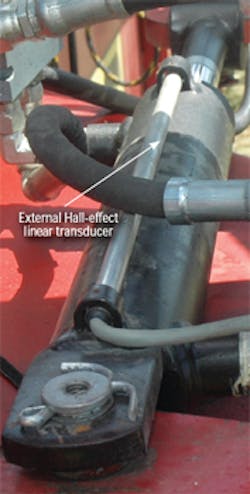

Cylinder from Energy Mfg. has a Hall effect sensor mounted along its barrel to sense position of a magnetic piston inside. The sensor is mounted without having to gundrill the piston rod, yet its small size and ...
Whenever some new off-highway machine is introduced, it almost always uses more electronics for automatic positioning of hydraulic cylinders. This trend is being driven by the need for:
Cylinder from Energy Mfg. has a Hall effect sensor mounted along its barrel to sense position of a magnetic piston inside. The sensor is mounted without having to gundrill the piston rod, yet its small size and location protect it from potential environmental damage.

Rota Engineering Ltd., Manchester, U.K., has developed a new design of LDT that eliminates the need for a gun-drilled piston rod. It uses Halleffect technology to sense the position of a magnetic piston through the barrel of a cylinder. A linear Hall-effect sensor positioned along the length of the cylinder barrel detects the position of the cylinder’s piston by sensing the position of a magnetic field formed by a permanent magnet embedded in the piston. As the piston rod extends or retracts, the magnetic field propagates through the cylinder wall to communicate with the linear Hall-effect sensor.
Several advantages stem from this approach:
• cost of achieving a smart cylinder is reduced by eliminating the need to gun-drill the piston rod,
• the cylinder is easier to assemble, install, and service,
• the permanent magnet in the piston should never need to be replaced,
• the external sensor is readily accessible and easy to replace if necessary,
• accuracy of the linear sensor is typically ± 0.5 mm (0.02 in) — more than adequate for most mobile equipment, and
• equipment manufacturers can prepare cylinders with magnets so that end users can add stroke sensing functionality at a later time.
