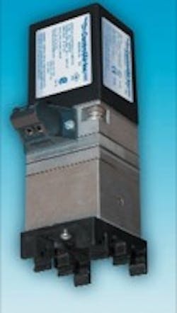

Type- 590X I/P transducer is small, lightweight, and insensitive to shock vibration and position change. Conversion technology using open-loop control and a low mass magnet produces accurate pressure control. It mounts in any position and is ...
Type- 590X I/P transducer is small, lightweight, and insensitive to shock vibration and position change. Conversion technology using open-loop control and a low mass magnet produces accurate pressure control. It mounts in any position and is impervious to RFI/EMI. It suits 1⁄8 in. port sizes and converts 4-20 mA input signal into 3 to 15, 3 to 27, or 6 to 30 psig output. It is rated for flows to 2.4 scfm.
