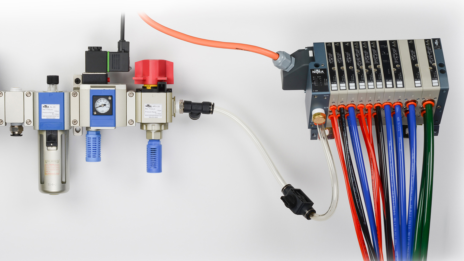

Putting it All Together
The normal installation order, from upstream to downstream, of pneumatic air preparation devices is:
  • System isolation valve
  • Filter
  • Regulator
  • Lubricator (if needed)
  • Device shut-off valve
Users can select the exact right combination of devices needed for their application. Because filtration is typically upstream of regulation, the filter needs to be rated to handle the supply air pressure. TAP units are a useful way to get most of these functions, other than lubrication.
