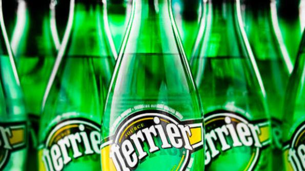

After molten glass reaches appropriate temperature, it is set into molds and blown familiar Perrier bottle shapes. (Click image to enlarge.)
The bottlers of Perrier mineral water manufacture their distinctive-looking bottles by blowing molten glass into molds. Each molding machine produces bottles for 24 hours a day, every day of the year — making production equipment reliability and integrity of utmost importance.
