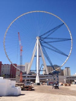

Located at a temporary chain-fall platform suspended below the wheel central hub, the air-operated hoists were the most practical choice for this application — clean, safe, and much lighter and more compact than electromechanical hoists. Plus, the spring-applied, pressure-released design of the air hoists prevents loads from dropping unexpectedly, even if a compressed air line would be severed. Their 280 ft of cable fall were used to their full advantage in lifting equipment from ground level. These lifts included 18 temporary radial struts (each weighing 40 tons), together with transfer trusses of similar weights and all the individual outer rim segments of the completed wheel. These were paired with a 112 cable-locking assemblies initially assembled at 50% tension loads.
The temporary radial struts were installed to provide the accurate spacing of the individual wheel rim segments from the central hub unit during initial assembly. These were then sequentially replaced by the cable-locking assemblies, which — when fully tensioned — provided the radial spokes of the completed wheel assembly.
