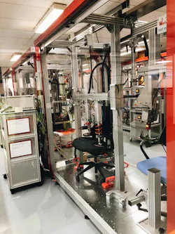

Test bench and laboratory systems play a crucial role in product development, validation, durability testing and lifecycle testing. These systems vary in size and complexity, many relying on linear actuators to apply controlled motion or load to a device under test.
Test engineers often face a different set of constraints than engineers designing production equipment. Test bench availability may be limited, development schedules can be aggressive, capital budgets may be tight, and a single system may need to accommodate multiple products or test profiles.
Once testing begins, the system may also be expected to cycle continuously for weeks or months while generating and logging consistent, reliable data.
These realities make the actuation system an important part of overall test system design. Reliability, flexibility, data acquisition, implementation time and operating cost should be considered alongside force, speed, stroke, duty cycle, and control requirements when evaluating hydraulic, electromechanical or hybrid actuation technologies.

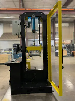

A hybrid linear actuator is a self-contained system that integrates a fluid-based cylinder with an electric servo motor and gear pump. This hybrid design combines the power density and load-handling capabilities of hydraulics with the control and flexibility of an electric actuator.
For test applications, hybrid actuation can be a good fit when higher forces, shock or side loading need to be balanced with control and changing test profiles. Power-on-demand operation can also help reduce energy use and heat generation during extended testing periods.
