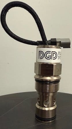

The CFT series of flow meters are configured as a cartridge valve, utilizing a standard Sun Hydraulics T-18A cavity. This allows easy integration into hydraulic manifolds for continuous flow monitoring without the need for additional bulky hardware or complex inline plumbing.
Additional features of the CFT Cartridge Flow Transmitter include:
  • Plug-and-Play Integration: Fits directly into a standard valve cavity, reducing footprint and leak points.
  • Advanced Electronics: Microprocessor-based platform with field-selectable flow ranges (up to 150 gpm) and multiple output profiles, including 4-20 mA, 1-10V DC and J1939 CANbus.
  • Extreme Durability: Rated for pressures up to 6,000 psi and operating temperatures up to 250 F (125 C), and with a low deltaP of less than 1 psi/gpm.
