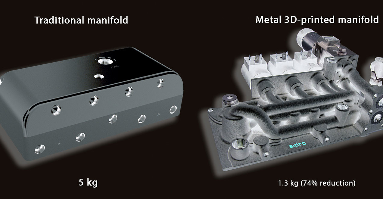

Components made using metal 3D printing can be smaller and, especially, lighter than equivalent components made by conventional methods. At left is a manifold that had been used in a portable power unit, and at right is the 3D-printed version, which weighs 74% less. (Image courtesy of Aidro SrL.)
This is in contrast to machined components, where the component (typically a manifold) begins as a solid block of metal, and the materialis removed to meet requirements. The limitation to this technology is that excess material usually is left in place to save the expense of removing it, resulting in parts that weigh more than necessary. Much of the excess metal could be removed to reduce weight, but doing so would add substantial manufacturing cost that rarely can be justified by the relatively small weight reduction.
Machining also is limited to producing many desired configurations, such as oval-shaped or squared-off fluid channels that can carry the same flow as a round channel, but in less space. Passageways in conventional manifolds often must be positioned to prevent cross-drilled channels from intersecting and allow enough material between channels to provide adequate strength. Auxiliary holes drilled to connect internal passageways usually must to be plugged to prevent cross-channel flow.

Furthermore, channel design can achieve greater flow within a smaller space. Passageways connecting internal channels don’t have to be machined from outside a manifold, eliminating the need for hole plugs.
Metal 3D-Printed Manifold
Aidro used this technology to manufacture a compact, lightweight manifold in a portable hydraulic power unit. The result is a hydraulic manifold that weighs about one-fourth that of its conventional counterpart machined from a solid block of metal. The 3D-printed manifold had to match up dimensionally to a previous design and also serve as the top to the HPU’s hydraulic reservoir. Without this restriction, the 3D printed manifold probably could have been made smaller, which would have reduced weight even more.
