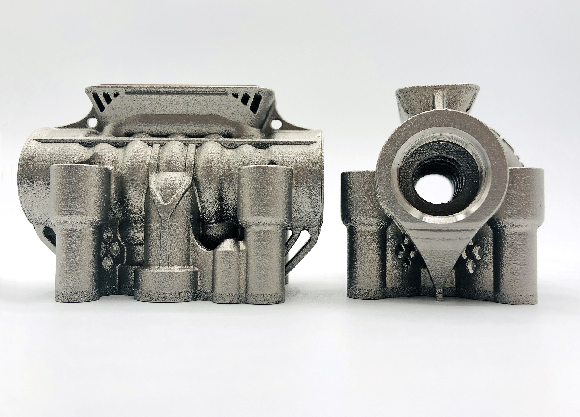

The strategic move to introduce additive manufacturing would set Aidro on a transformative journey that required the company to redesign and produce 3D products such as 3D-printed hydraulic spools, heat exchangers, valves and high-pressure hydraulic manifolds. Since then, the company has seen a surge in digital transformation, explained Tirelli.

The meaning of additive manufacturing is to add material only where it is needed. Thanks to our ability to design fluid parts with this new additive manufacturing approaches, we are able to reduce the weight of the part, use less material, produce it faster compared to conventional methods. And, we are moving now to high-volume production that will be possible with Desktop Metal’s technology of binder jetting.

But it’s not only at the research and prototyping level that additive manufacturing is interesting. We started to design—with the new mentality of additive manufacturing—functional parts for small series CETOP valves, which we made in stainless steel. We added this material especially for corrosion environments.
And we were able to have lighter components. To lighten components is very important for mobile applications, like agricultural machinery or off-highway vehicles, where more electrification is a new trend. And of course, it’s possible to reduce the weight of the different hydraulic components using additive manufacturing. This means using less energy to move the machine and less oil consumption.
Also, the possibility to customize the shape and, in some cases, the shape of the hydraulic systems and hydraulics component that should be customized to take into account the space that is available inside the machine. So, more and more, we are able to exactly fit the spaces that are in the systems, and create the exact part with the exact shape that is needed.
Another benefit is the possibility to combine multiple components into one. Just a few weeks ago we presented an approach with a CNH Industrial, where we combined two hydraulic manifolds into one. For example, we reduced the assembly time, we reduced the ceilings and the o-rings that connect into manifolds. We also have benefits in the logistics; because we have only one part there are benefits for the purchasing department. So, you see, there are very different benefits in different applications.
