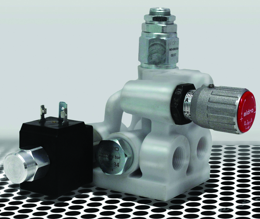

This 3D-printed hydraulic valve block is made of stainless steel for controlling a single-acting cylinder. The process uses a computer-controlled laser to melt stainless steel powder layer by layer. (Image courtesy of Aidro SrL).
Alberto Tacconelli, Managing Director at Aidro SrL, Taino, Italy, explains that 3D printed components are best suited to highly specialized applications, not large production volumes. Aidro designs and manufactures conventional and 3D printed hydraulic components. “With additive manufacturing, we can create highly customized components that are smaller, lighter, and often with higher efficiency or performance than those built using conventional techniques.”
Tacconelli continues, “Because of its ability to build internal features and passageways, additive manufacturing is well suited for the design and manufacture of manifolds. Our internal channels of the valve block (shown on page 12) are optimized for greater flow within a smaller space. Furthermore, the potential for leaks is eliminated because auxiliary drillings (hole plugs) are not needed.
